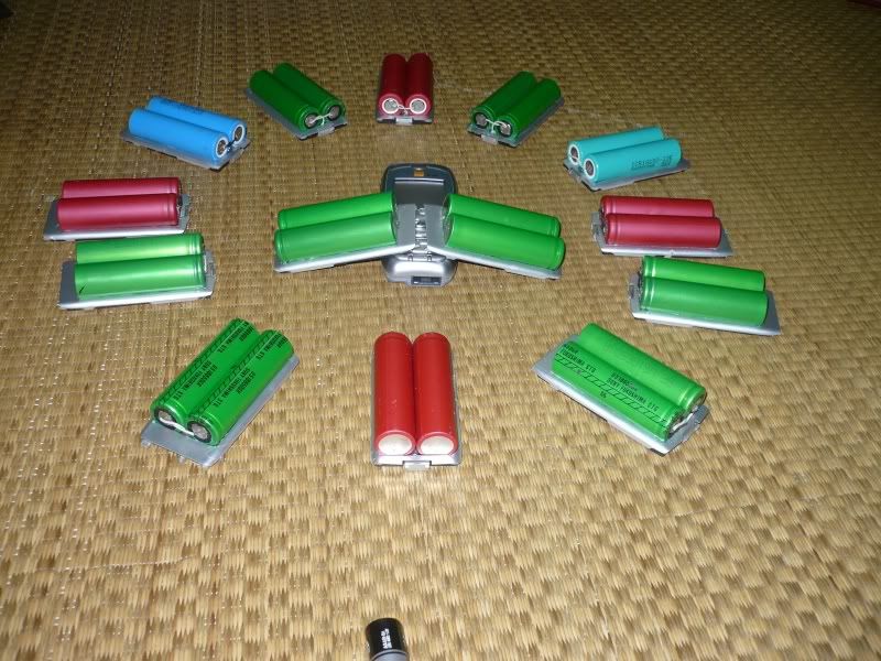

Postby tungden » June 26th, 2010, 12:23 am
http://www.SL4x.com the web for SL45 in vietnamese
so i can introduce everybody the battery for SL45 too big and too long hehe
i can spend this to music 3days always and 25day for standby,what r U thinking about?

Postby tungden » June 26th, 2010, 1:13 am
kokakokbrut wrote:
tungden wrote:i can spend this to music 3days always and 25day for standby
:-O really ???
any laptop cell can be used for this project and how many time for charging ?
sorry if my english is bad :D
please if you dont mind, sharing details how to modif the laptop battery into Sl45. because the size laptop battery bigger than sl45 battery
real,i don't joke
i spend 2 cell,2200mah per cell and i join parallel 2 cell to make 4400mah,i spend the IC board changer of SL45 bat orin,full changer about 10hour
i don't think so! that cover batteryl of SL45 biger than 2 cell laptop,,you can try it!

Postby tungden » June 26th, 2010, 2:10 am
Hendz wrote:Tha' was GREAT WORK, though its lil weird :)
And I think as of laptop ones but, had special connectivity to put it up into the phone, right?
thanks but that not had specical connection! that simple,imagine you replace the cell orin = cell laptop,,

Postby Hendz » June 26th, 2010, 2:27 am
How could you put that on batt compartment? Isnt it narrow enough to do so?
Well I guess I'm quiet difficult to imagine it except when you flatten-out those batts on one side, and then join it together in the hole.
Or,,,, you got a chance to see if the SL45 had "unprecisely" two-fitted batteries, yea,,, anyway,,, that's remarkabL :) :)
Long lasting powers I believe it, too,,,, :) :)
