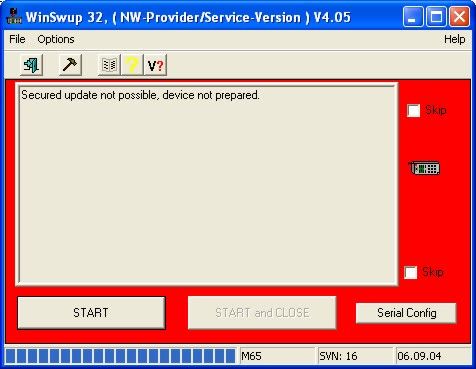

Jika dalam update firmware dg winswup muncul sperti ini :
merujuk ke problem yg pernah di alami oleh Mas Herry Potter dalam update FW (Firmware) M65 di viewtopic.php?f=49&t=750
> factor yg mempengaruhi : Hash FFFF (cek dg aplikasi java getcode) dan FFS Corupt

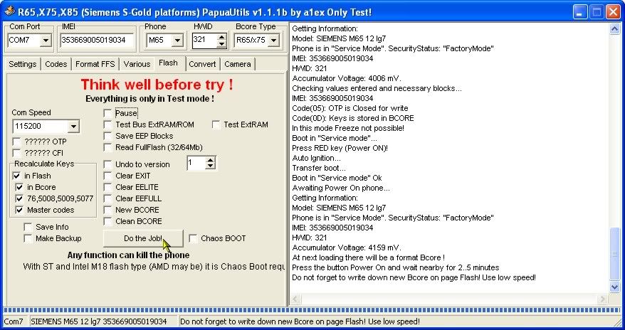

14. Go to Flash tab and put check-mark on :
- In Flash
- In Bcore
- 76, 5008, 5009, 5077
- Master codes
15. Click on “Do the Job”
16. Short press red button
17. Go to Settings tab and click on “Service Mode”
18. Shortpress red button
19. Go to Various tab, click on “Read IMEI”
20. Click on “Freeze”
21. “In this mode Feeze not possible”
22. Open FFS Format tab
23. Click on “BCORE”
24. Click on “Yes”
25. Click again on “Yes”
26. Wait…
27. Push red button to switch off phone
28. Push red button and wait 2 – 5 minutes (Nothing happened on the phone. Just wait!!!)

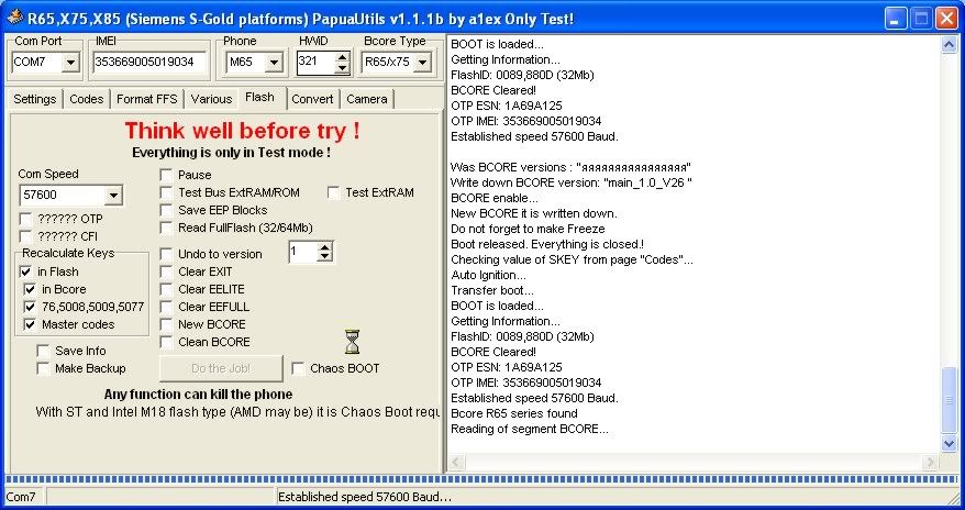

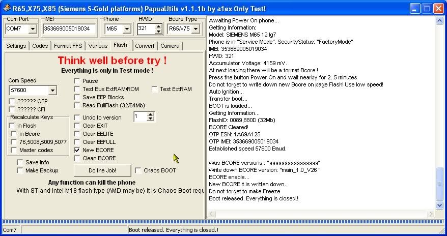

29. Go to “Flash” tab and put check-mark only on “New BCORE”
30. Click on “Do the Job”
31. Short press red button to auto ignition
32. Then in “Flash” tab, put check mark only on :
- In Flash
- In Bcore
- Master codes
33. Click on “Do the Job”

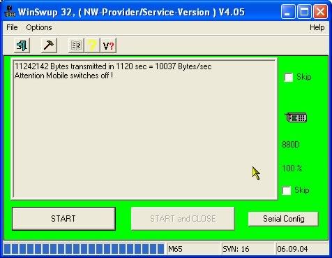

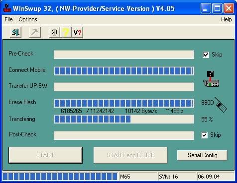

41. Run WinSwup
42. Put check-mark on “Pre-Check” and “Post-Check”
43. Click “Start” and short press red button
44. Voila…WinSwup works fine….wait until finish.
